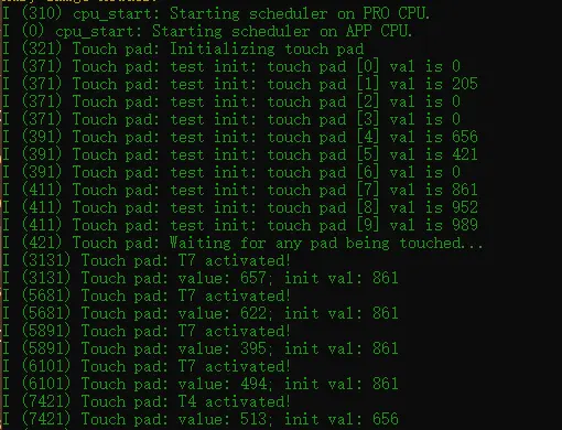

六、轮询检测按键
根据 esp-idfexamplesperipheralstouch_pad_interrupt 中的例程修改
#include #include 'freertos/FreeRTOS.h'#include 'freertos/task.h'#include 'freertos/queue.h'#include 'esp_log.h'#include 'driver/touch_pad.h'#include 'soc/rtc_periph.h'#include 'soc/sens_periph.h'static const char *TAG = 'Touch pad';#define TOUCH_THRESH_NO_USE   (0)#define TOUCH_THRESH_PERCENT  (80)#define TOUCHPAD_FILTER_TOUCH_PERIOD (10)static bool s_pad_activated[TOUCH_PAD_MAX];static uint32_t s_pad_init_val[TOUCH_PAD_MAX];/*

 */static void tp_example_read_task(void *pvParameter){
    static int show_message;
    while (1) {
        for (int i = 0; i < TOUCH_PAD_MAX; i++) {
            uint16_t value = 0;
            touch_pad_read_filtered(i, &value);
            if (value < s_pad_init_val[i] * TOUCH_THRESH_PERCENT / 100) {
                ESP_LOGI(TAG, 'T%d activated!', i);
                ESP_LOGI(TAG, 'value: %d; init val: %d', value, s_pad_init_val[i]);
                vTaskDelay(200 / portTICK_PERIOD_MS);

查看打印:
