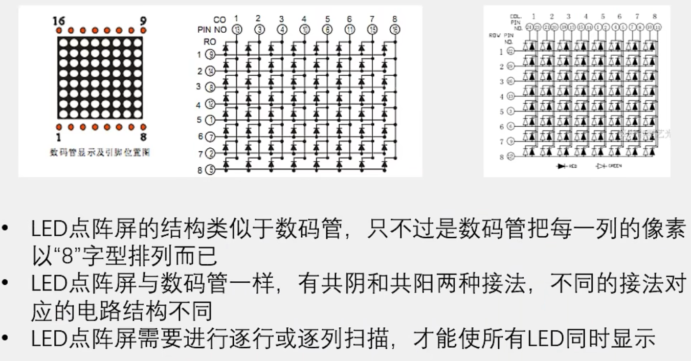

介绍
image-20231110180748784
显示原理

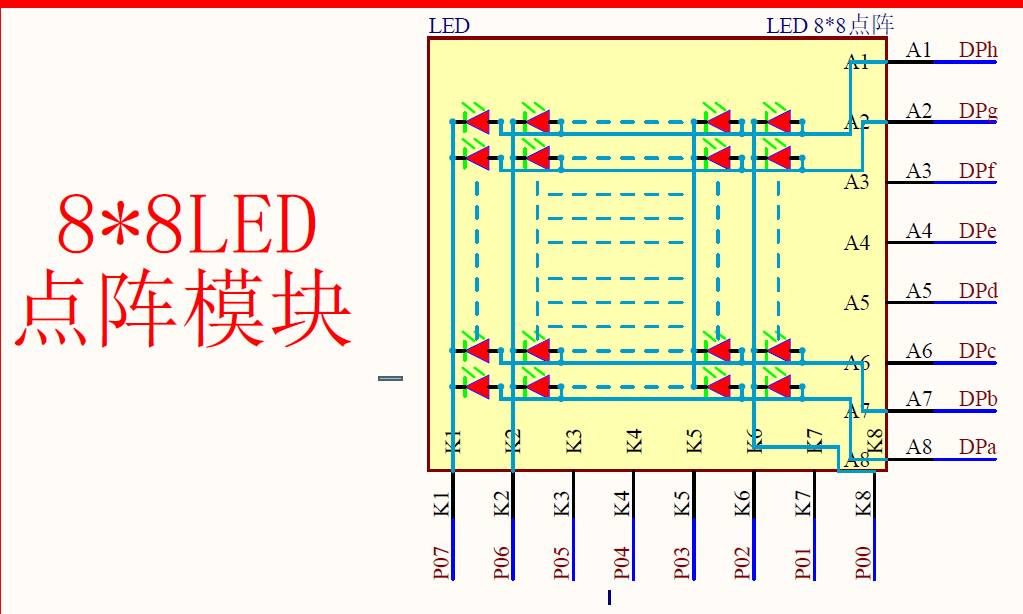

image-20231111134434728
原理图
image-20231111140548379
image-20231111140703039

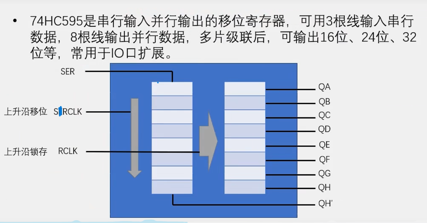

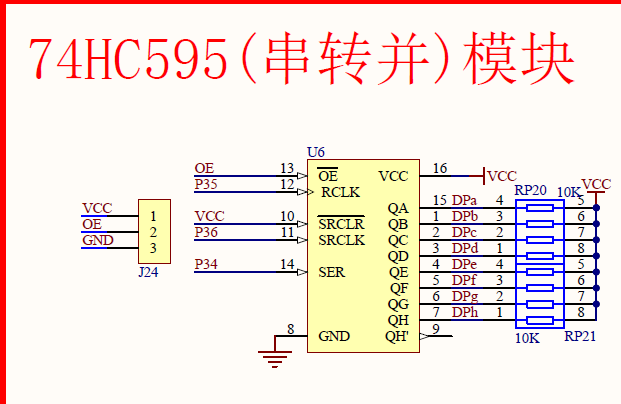

74HC595
image-20231111141228385

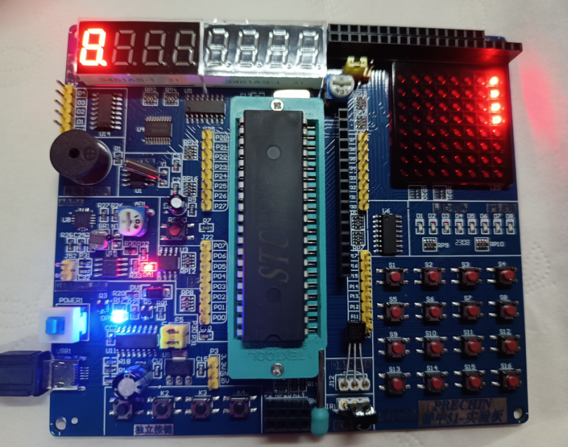

选择列来显示矩阵LED
main.c
#include
#inlcude 'Delay.h'
sbit mRCLK=P3^5; //RCLK
sbit mSRCLK=P3^6; //SRCLK
sbit mSER=P3^4; //SER
void _74HC595_WriteByte(unsigned char Byte)
unsigned char i;
mSRCLK=0;
mRCLK=0;
for(i=0;i<8;i++)
mSER=Byte&(0x80>>i); //sbit非0置1
mSRCLK=1;
mSRCLK=0;
mRCLK=1;
void MatrixLED_ShowColumn(unsigned char Column, Data)
_74HC595_WriteByte(Data);
P0=~(0x80>>Column);
void main()
MatrixLED_ShowColumn(7,0xF0);
while(1)

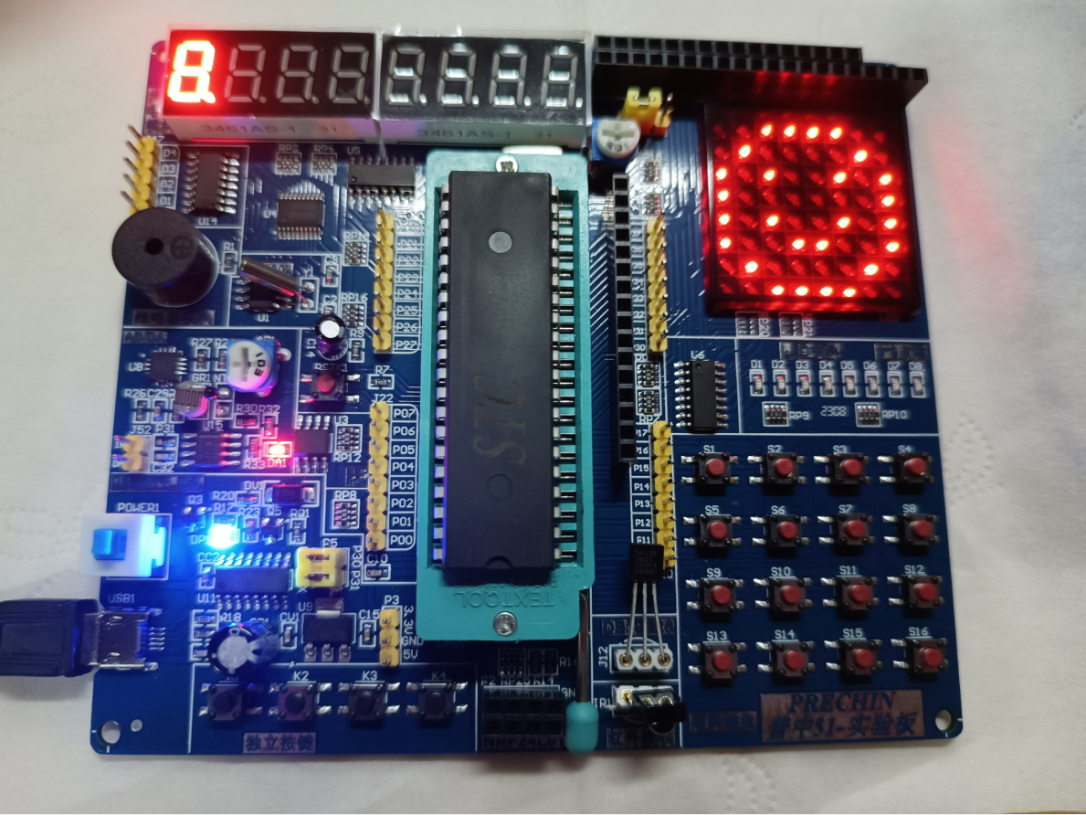

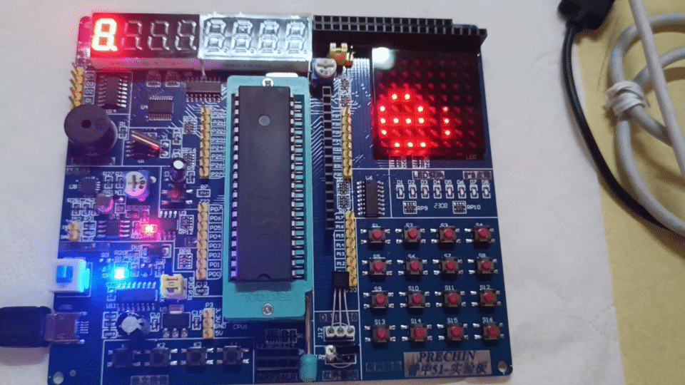

运行效果
image-20231111165828006
矩阵LED显示笑脸

运行效果
image-20231111184211362

运行效果
VID_20231112_131850
