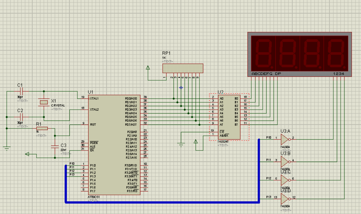

C51单片机四位数码管动态显示2020
2025-09-30 来源:bilibili
电路原理图
元件清单
程序(C语言)
#include<reg51.h>
unsigned char smg[]={0x5b,0x3f,0x5b,0x3f};//2020字形码(共阳极)
void delay(unsigned int time);
void main()
   unsigned char i,W;
   while(1)
    W=0x01;
    for(i=0;i<4;i++)
     P1=W;
W<<=1;
      P0=smg[i];
     delay(10);
   unsigned int j=0;
   for(;time> 0;time--)
   for(j=0;j<125;j++);
#include<reg51.h>unsigned char smg[]={0x5b,0x3f,0x5b,0x3f};//2020字形码(共阳极)void delay(unsigned int time);void main(){
   unsigned char i,W;
   while(1)
    W=0x01;
    for(i=0;i<4;i++)
     P1=W;
W<<=1;
      P0=smg[i];
     delay(10);
}}void delay(unsigned int time){
   unsigned int j=0;
   for(j=0;j<125;j++);}
