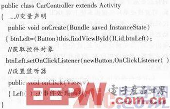

Android applications are developed based on many Android API components. The following are some of the main API components: The current active program is the most commonly used application component. An activity can be simply understood as a screen that the user sees, called an "activity." It is mainly used to handle the overall work of the program, and implements running, pausing, and stopping states by calling methods such as onCreate(), onStart(), onRestart(), onResume(), onStop(), and onDestroy(). For example, it listens for events such as keystrokes and touch screens, specifies an image display View, and starts other activities. Android uses the Intent class to start other activities. It calls the startActivity(myIntent) method to trigger the parsing of the myIntent action. After receiving the myIntent notification, the new activity begins running. For example, switching activities can achieve switching display layouts. The ContentProvider class is a special type of data storage that implements data storage and sharing. A Service is an application component that runs in the background and does not directly interact with the user. The current active program can use Context.
StartService() starts a background service and can also communicate with the background service through Context.bindService(). In Android Java programs, controls that implement human-computer interaction are handled through events, and it is necessary to specify the event listeners used by the controls. The event response code is as follows:
