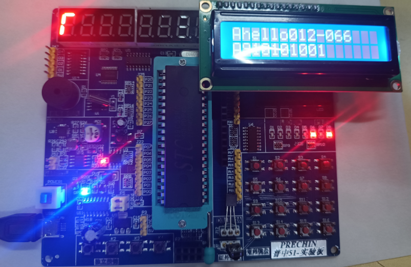

main.c
#include
#include 'LCD1602.h'
void main()
LCD_Init();
LCD_ShowChar(1,1,'A');
LCD_ShowString(1,2,'hello');
LCD_ShowNum(1,7,123,4);
LCD_ShowSignedNum(1,10,-66,3);
LCD_ShowHexNum(2,1,0xA9,2);
LCD_ShowBinNum(2,3,0xA9,8);
while(1)
运行效果
image-20231107181137927
