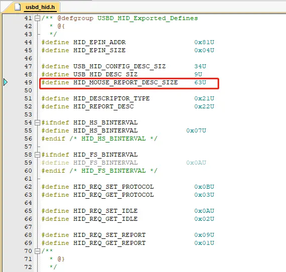

6.3 修改报告描述符大小
打开usbd_hid.h文件,修改HID_MOUSE_REPORT_DESC_SIZE的值为63。

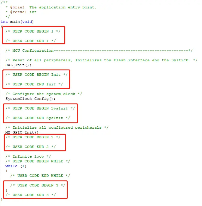

七、修改main.c
添加头文件和USB设备句柄。
/* Private includes ----------------------------------------------------------*/
/* USER CODE BEGIN Includes */
#include 'usbd_hid.h'
/* USER CODE END Includes */
/* Private variables ---------------------------------------------------------*/
/* USER CODE BEGIN PV */
extern USBD_HandleTypeDef hUsbDeviceFS;
添加一个数组变量,用于传输键盘参数的,Byte0是传控制键,Byte1是保留键,不用改;Byte3~byte7都可以存放传输的按键值。
 * buffer[0] - bit0: Left CTRL
 *           -bit1: Left SHIFT
 *           -bit2: Left ALT
 *           -bit3: Left GUI
 *           -bit4: Right CTRL
 *           -bit5: Right SHIFT
 *           -bit6: Right ALT
 *           -bit7: Right GUI
 * buffer[1] - Padding = Always 0x00
 * buffer[2] - Key 1
 * buffer[3] - Key 2
 * buffer[4] - Key 3
 * buffer[5] - Key 4
 * buffer[6] - Key 5
 * buffer[7] - Key 6
uint8_t buffer[8] = {0x00, 0x00, 0x00, 0x00, 0x00, 0x00, 0x00, 0x00};
/* USER CODE END PV */
添加按键检测及传输键值到电脑。
  * @brief  The application entry point.
  * @retval int
int main(void)
  /* USER CODE BEGIN 1 */
  /* USER CODE END 1 */
  /* MCU Configuration--------------------------------------------------------*/
  /* Reset of all peripherals, Initializes the Flash interface and the Systick. */
  HAL_Init();
  /* USER CODE BEGIN Init */
  /* USER CODE END Init */
  /* Configure the system clock */
  SystemClock_Config();
  /* USER CODE BEGIN SysInit */
  /* USER CODE END SysInit */
  /* Initialize all configured peripherals */
  MX_GPIO_Init();
  MX_USB_DEVICE_Init();
  /* USER CODE BEGIN 2 */
  /* USER CODE END 2 */
  /* Infinite loop */
  /* USER CODE BEGIN WHILE */

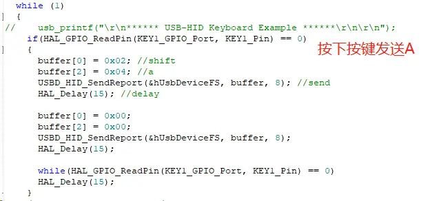

  while (1)
//    usb_printf('rn****** USB-HID Keyboard Example ******rnrn');
    if(HAL_GPIO_ReadPin(KEY1_GPIO_Port, KEY1_Pin) == 0)
      buffer[0] = 0x02; //shift
      buffer[2] = 0x04; //a
      USBD_HID_SendReport(&hUsbDeviceFS, buffer, 8); //send
      HAL_Delay(15); //delay
      buffer[0] = 0x00;
      buffer[2] = 0x00;
      HAL_Delay(15);
      while(HAL_GPIO_ReadPin(KEY1_GPIO_Port, KEY1_Pin) == 0)
      HAL_Delay(15);
    /* USER CODE END WHILE */
    /* USER CODE BEGIN 3 */
  /* USER CODE END 3 */

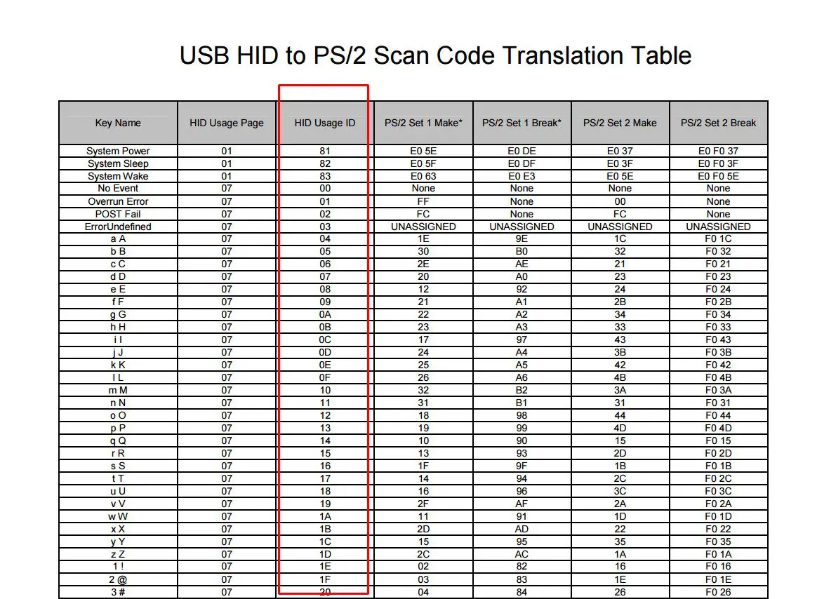

对应键值可和此文件中的HID Usage ID对应,是16进制(如字符‘a’对应键值为0x04)
USB_HIDtoKBScanCodeTranslationTable.pdf

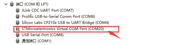

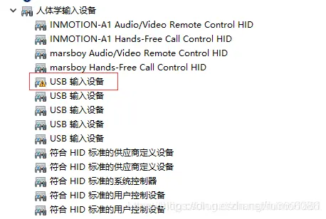

八、查看效果
编译工程,下载到板子上,插上USB线连接到电脑上,识别出为键盘设备
注意: 如果设备带有感叹号,则参考下面十、注意事项
按下按键时在电脑上输入一个大写的‘A’。

用户代码要加在 USER CODE BEGIN N 和 USER CODE END N 之间,否则下次使用 STM32CubeMX 重新生成代码后,会被删除。

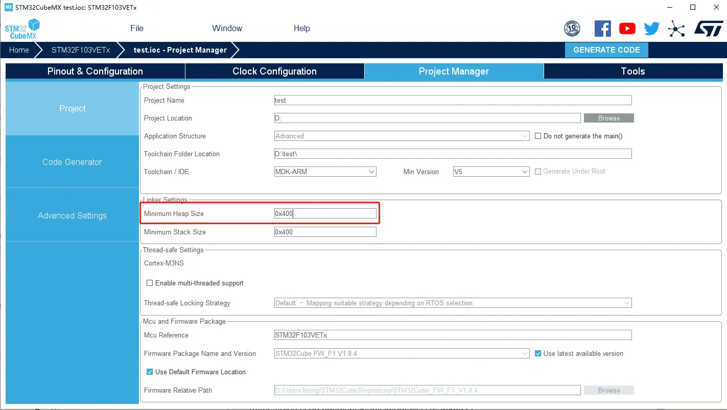

如果USB端口出现感叹号设备无法启动的问题,可适当将堆改大,如0x400
