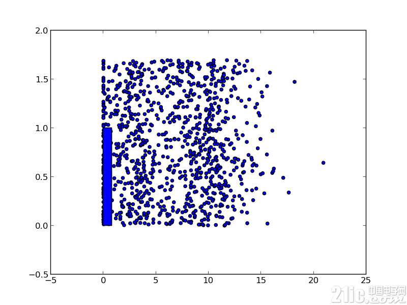

使用Matplotlib制作原始数据的散点图
fig = plt.figure()
ax = fig.add_subplot(131)
ax.scatter(datingDataMat[:,1],datingDataMat[:,2])
ax = fig.add_subplot(132)
ax.scatter(datingDataMat[:,1],datingDataMat[:,2],15.0*array(vector),15.0*array(vector))
ax = fig.add_subplot(133)
ax.scatter(datingDataMat[:,0],datingDataMat[:,1],15.0*array(vector),15.0*array(vector))
plt.show()
